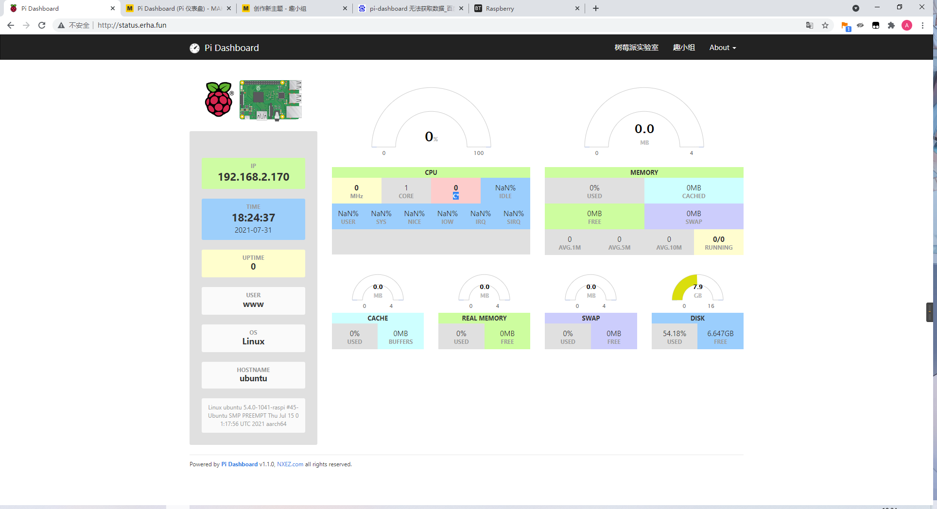

该系统已安装宝塔面板,Nginx+PHP7.1 具体如图
具体如图

这是宝塔面板对 wwwroot 目录权限的限制。你可以访问 device.php 看看,应该会报错。
目前我没有办法测试,如果是这样的话,你可以从文件的执行权限方面找找解决方法。

用户名和用户组都是www
具体权限如图
访问 device.php 的时候状态码是200的

访问这个URL
http://IP地址/pi-dashboard/index.php?ajax=true
Ackerven
10cm
2021-08-02
{"page":{"time":{"start":["0.03957300","1627912010"]}},"time":1627912010,"uptime":0,"cpu":{"freq":0,"stat":{"user":0,"nice":0,"sys":0,"idle":0,"iowait":0,"irq":0,"softirq":0},"temp":0},"mem":{"total":0,"free":0,"buffers":0,"cached":0,"cached_percent":0,"used":0,"percent":0,"real":{"used":0,"free":0,"percent":0},"swap":{"total":0,"free":0,"used":0,"percent":0}},"load_avg":[0,0,0,"0\/0"],"disk":{"total":14.507,"free":6.137,"used":8.37,"percent":57.7},"net":{"count":0}}
